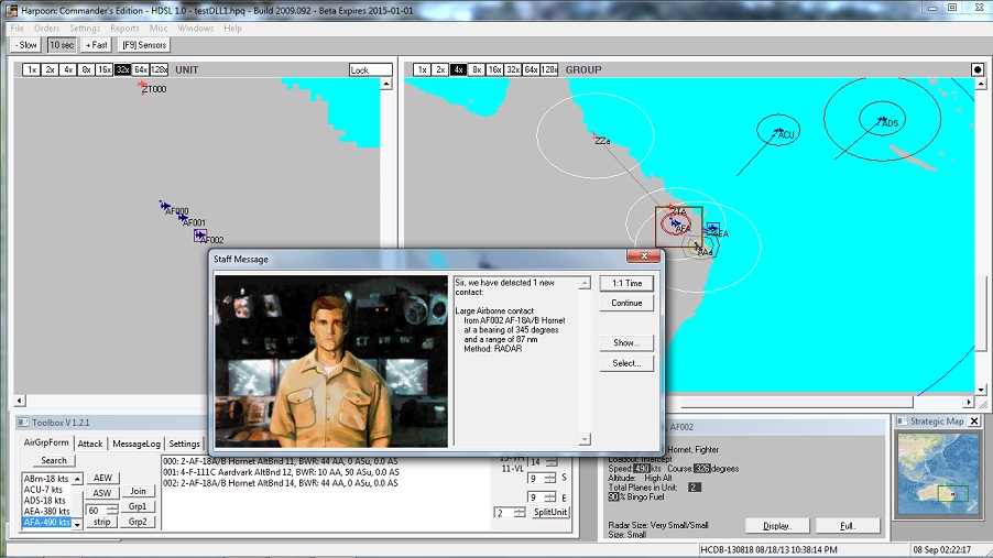

Currently working on splitting a selected number of aircraft from a selected unit.
In this case group AFA comprises two fighter (AF00) ~15 mile ahead of the 4 strikers (AF01) at the group centre - both units flying vlow - and two further fighters (AF02) flying high and ~15 mile astern with intermittent radar. An incoming interceptor has just been detected and with a few mouse clicks I will split off one of the forward fighters to defend against the enemy interceptor.
The strike formation was formed from a strike group comprising 4 each F18s and F111s, once air borne two F18s were split of then joined back to the original group, then the off set feature of the toolbox was used to push one fighter unit ahead and one astern and each units altitude set as desired.
Note the AEW doing a couple of circles of home base with intermittent radar - set up using the AEW patrol function.
