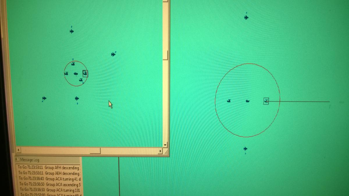

  9. Issue Information Issue ID #000192 Issue Type Issue Severity0 - None Assigned Status 23 - Fix Accepted by Reporter Version 2017.011 Fixed in 2017.013 Center circle of CVBG anomoly Posted by Tony on 26 September 2017 - 06:45 PM The action I notice after loading 2017.11 is any adjustment to the center ring of a carrier group causes the ships put in or adjusted to the in the center ring immediately changes it individual course to N NE. The ship type does not matter only that it seems a carrier has to have been their in the start. I have produce a test scenario with three saves after certain actions were taken to a CVBG ( AAC) and a SAG (ABS). The groups course is due south in all saves. In the first save it is after just adjusting both formations outer ring to 40 the CVBG ships in the center circle turn to approximately 35 degrees while the SAG center circle ships just made a slight adjustment and the headed south again. The carriers did not correct at all. In the second save I just readjusted the ships in the center circle causing the groups to react in the same way as before. In the third save I added the northern escort from the second ring to the center ring of both groups. In this case the added ship in the CVBG turn to a heading of 35 degrees and did not correct while the SAG escort added just adjusted and moved into the center ring. In short when adding any ship to the center circle of a group including a CV the response was to turn to 35 degrees and sail from the formation. I do want to give credit to the guys who keep updating this game and wish I could do more the just find issues but do enjoy the game and appreciate the work. Sorry for mistyped heading. Thanks for any help or advice once again Tony issue-192-center-circle-of-cvbg-anomoly.pdf CVtest.zip After splitting AC group.zip FormationKeeping.zip
