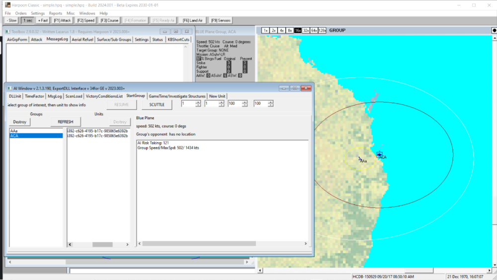

  6. TonyE has come up with a lead which has given good results, further testing and AIWindow.dll interrogation shows that a key identifier (unit's UUID) is not being generated for new units formed when a unit within a group is split by virtue of splitting the group (F8) but is copied from the original thus two units have the same (meant to be unique) Unit UUID. If the new and original units are together again in the same group then only one will land.
    In the screen shot, centre window, the data is for the selected group's units, the numbers should be unique.
