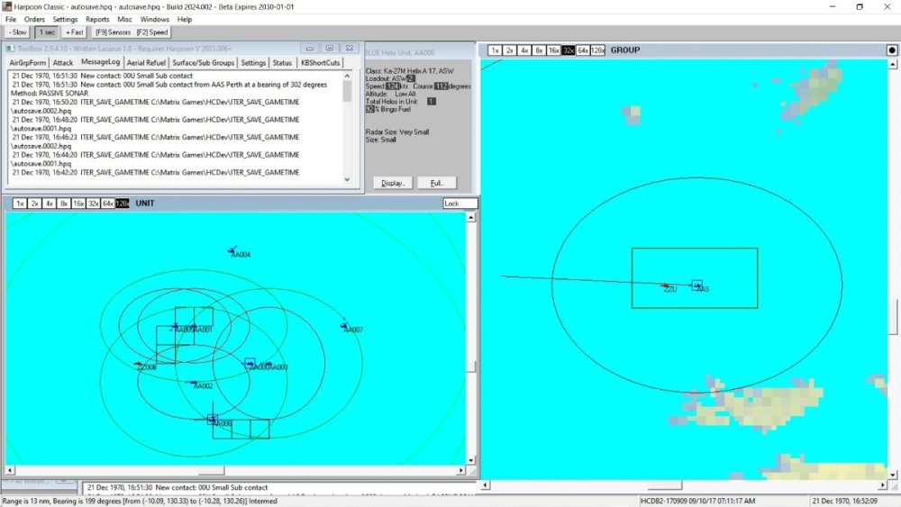

  3. I've tried a few chopper loadouts, ASW, ASW-LR, ASW-2 and MCM.
    When they are sent out alone on independant patrol (so F6 'Launch' - type 'Patrol') all fly at low alt. BUT when I put them in group formation patrol (F4) the MCM fly at mediium, the other three at low. I better look for some ASW-3 and try them?
    I found an ASW-3 (and for giggles a Nuke). ASW-3 flew both patrols (Stand alone and group formation) at low altband and Nuke guy did group formation patrol at medium (AEW patrol in the unit info window) and low alt for stand alone.
    I've no idea where I'm going with this, but it's interesting
  4. At it again tonight and I see Enrique as you say in group formation the MCM mission choppers fly at medium altBand :(
    To make it easier to get contacts I've added NOise Makers. I've not used them before, they are certainly detected further out.
    I've tried some (soviet) choppers with an ASW loadout utilising DC, so small weapon range, and they seem to behave same as the mcm choppers in that if directed to attack out of weapon range they will fly past known higer unit number mines to attack the lowest unit number mine, but if within range of a mine at time they are ordered to attack they will attack that (those) mines. So I'm thinking it's not an 'MCM' thing.
    II'll start looking at the mission - loadout patrol altband thing.
  5. A little more work last night, what I saw was that if the MCM chopper was right over a mine unit that had an exact fix, it would attack it, otherwise it went for the lowest unit number mine. Now I wonder if the difference also relates to the range of the weapon (7 nm torpedo, 1/2 nm EOD).
    Next I might put in the mix a chopper with depth charge, so that will be ASW mission but very short range weapon.
  6. I've been playing tonight with choppers hunting sea mines.
    Usually done using MCM specific choppers there has been an observed (by at least a couple of us) possible flaw if there are multiple mines detected then the choppers attck them in target unit number order, not closest first. Fooling around a bit I'm guessing that if the chopper has a mission type MCM then it will do this, but if you add to the chopper group an ASW mission chopper, or use an ASW mission chopper alone (depth charge seem a reasonable sim) (you can see the mission type in the unit information window (click on the chopper in the unit window)) then you get attack sequence in order of proximity (more desirable).
    Has any one else noticed this sort of thing and got thoughts on it?
