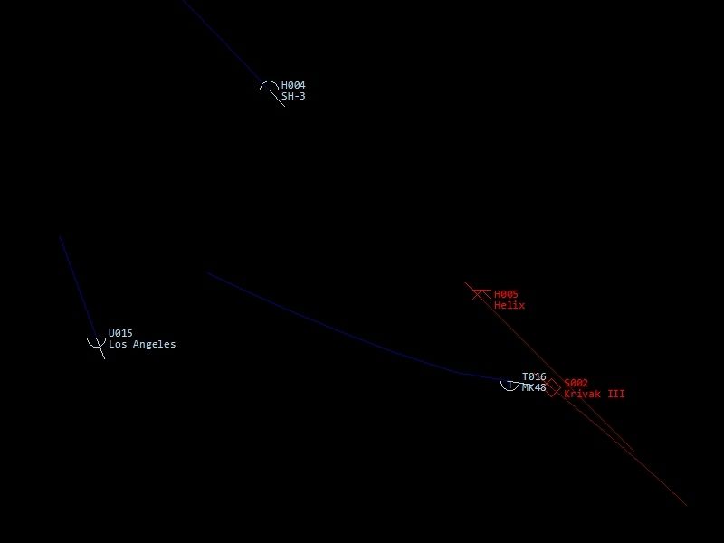

  6. Steve,
    When I load the Dinner at Six O'clock scenario I see the blue icon in the middle of the screen, with the red icon in the upper left. To equalize the screen, right click at a point half way between the two units. That should allow you to see both. Also, please be aware that the info at the left side of the screen is not "see-through." If a unit is plotted behind it, you will have to right click the screen to move the unit into view.
    If you think you may have right clicked yourself too far away from the units, just use the "C" key to recenter the screen. You can also try "zooming out" to see all the units.
    Did you change the colors? If the background color is the same as either side, then you will not see them. You could try using the default colors just to see if they come back.

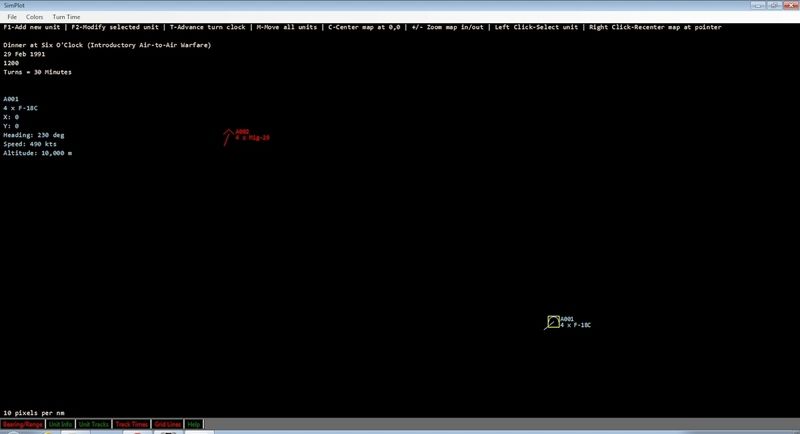

  9. I created a simple plotter (SimPlot) program that automates the process of moving units on a simple x,y coordinate system. The objective is to get myself to play H4 paper rules more often by eliminating the problems of graph paper or Neptune's Cat attacks for tabletop games.
    SimPlot will track time and motion of units. It will also provide range and bearing info to other units. Units can automatically follow other units that are selected as "targets." Unit movement tracks and times can be displayed in case you want to see where you have been.
    How about a few screenies?
    I was hoping to show the unit tracks, but it looks like Photobucket may have changed the image a bit. Anyway, the colors in the game are changeable so you can select whatever colors you like.
    There is an option to display bearing and range data from a selected unit to all other units. This will make calculating detection easier.
    Units can automatically follow other units by assigning them as "targets." Of course, you can still order a unit to follow a set heading.
    There is a readme file within the zipped folder that has details of how to use the program. I hope that most of it is intuitive. still, I will answer any questions you may have about the program.
    I forgot to mention that to get started you have to either create a new scenario (very easy--fill in the form, press OK, and then add units) or load an existing scenario. I included two simple scenarios to get you started.
    SimPlot.zip

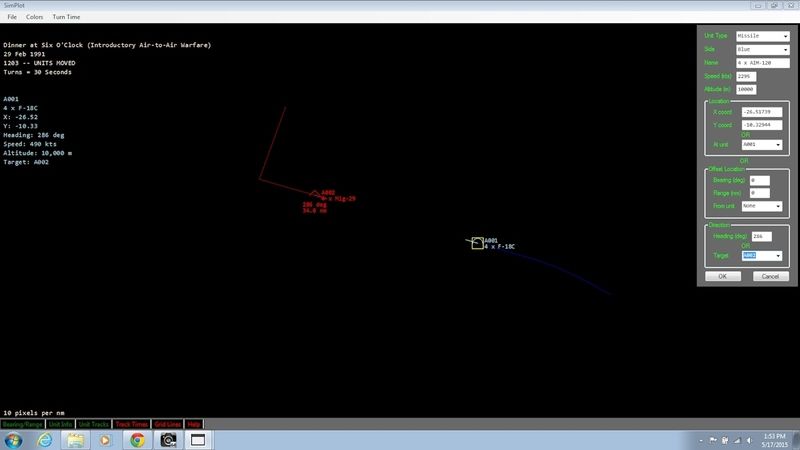

  10. I created a simple plotter (SimPlot) program that automates the process of moving units on a simple x,y coordinate system. The objective is to get myself to play H4 paper rules more often by eliminating the problems of graph paper or Neptune's Cat attacks for tabletop games.
    Well, the image came out smaller that I wanted, so I hope you can still read it.
    Selecting a unit will display additional information on the left side. The status bar buttons on the bottom will toggle other on-screen information. Never mind the grid lines for now because they are terrible.
    Both aircraft groups have detected each other and the F-18 group will now fire AIM-120 missiles. Once the OK button is pressed the missiles will appear on top of the F-18 icon and will not move until next turn.
    Now we got some action! I zoomed the map in so you can see how the missiles are tracking their targets. I don't have to figure out a new heading each time they move. Units can be added, modified, or removed as needed. Currently, the program supports aircraft, helicopters, missiles, surface ships, submarines, torpedoes, sonobuoys, and reference points.
