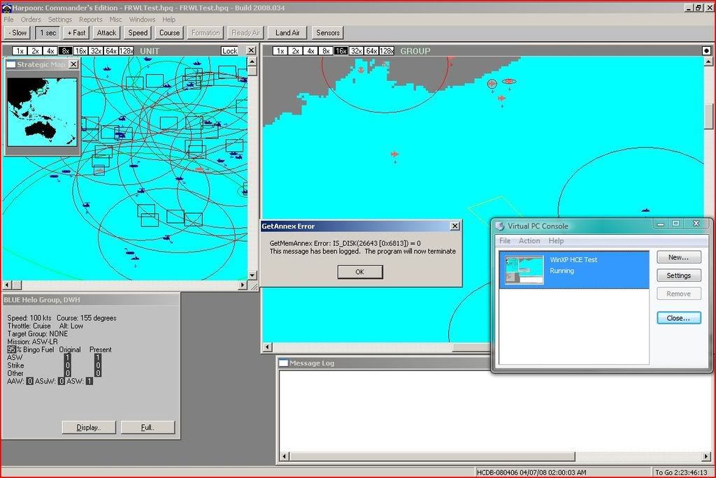

Posted 26 April 2008 - 02:02 PM
HCE 2008.034
This fix was tested and appeared to work, but after running the scenario for about 10 seconds it then crashed with the following error:
Posted Image
Can someone please confim they experience this also.
#6 TonyE
TonyE
    Advanced Member
  • Staff Pukes
  • PipPipPip
  • 3,171 posts
Posted 26 April 2008 - 02:08 PM
Yup, I get what you get Stalin, a bit more than 10 seconds but it happens.
#7 TonyE
TonyE
    Advanced Member
  • Staff Pukes
  • PipPipPip
  • 3,171 posts
Posted 26 April 2008 - 03:46 PM
okay, 2008.035 gets past the 2nd bug, what's next <g>

#11 Stalintc
Stalintc
    Advanced Member
  • Members
  • PipPipPip
  • 94 posts
Posted 27 April 2008 - 11:41 AM
HCE - 2008.035
Tested with save displaying original fault.
Scenario continues without further error.
Confirmed fix works as planned.
