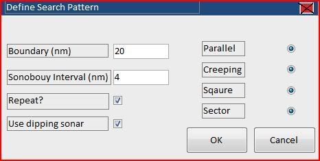

Further to the above statements, I wanted to add something with regards to the user end of the operation, what control I feel the user may need to have over the process.
Workings
1) User decides where they would like to setup an ASW patrol
2) User selects the group containing the aircraft they would like to launch on that patrol.
3) User clicks *Launch* as normal and then is prompted for a patrol type.
4) User then puts radio button in what would be a fourth one, for ASW Patrol.
5) User is then prompted for the location of the search and would click on the map as if they were selecting a patrol destination, at the epicentre of the ASW search.
6) User is then prompted with a dialogue box similar to what is attached to this post asking them for the details of what search they would like.
7) After clicking *OK* the user is now prompted for what aircraft like they would like to assing as normal. (preferrably with only ASW capable aircraft in the list <g> )
Intergration into other parts of the interface
The above will work fine, until the player attempts to change the unit course to something else... of course the player should be entitled to do so. And perhaps there should be a button on the top bar which can re-initiate the above process. It is also inevitable on that note that the player may wish to change the location of the search, which would heighten the need for a button re-initiate the process even more. There would be no point having the feature if it could not be accessed at any time like *Attack* for example.
New Menu Explained
Here is a brief explanation of what the items in the menu in the attached image should do.
> Four radio buttons on right - Pass the argument to the AI as to what search pattern to use and plots a course according to this. This will affect the main part of how the AI behaves on the course too.
> Boundary - Define to the AI in nm how far the boundary of the search is to stretch.
> Sonobuoy Interval - Define to the AI how often to drop sonobuoys
> Repeat? - Checkbox to make the AI perform the search course, but then replot and do it again in a loop until other orders are issued.
> Use dipping sonar - Checkbox to make the AI stop at intervals to use its dipping sonar (providing it has one)
Posted Image

Posted 22 April 2008 - 06:09 PM
Workings
New Menu Explained
Posted Image
That looks as good (or better) than anything I could come up with. I would suggest adding MDR to the Weather Conditions report for any point to enable the player to determine buoy spacing for his plan. Layer pepth would be helpful as well.
Buddha

Posted 22 April 2008 - 06:26 PM
Ok, now refine it guys, what's wrong with that picture (think aligning the search). Buddha's 5-6-5 distro isn't specifically mentioned, should it be?
How does the AI side decide which methods it should use?
How does this influence scenario design, what does the scenario designer have for choices, etc...
Keep working it guys.

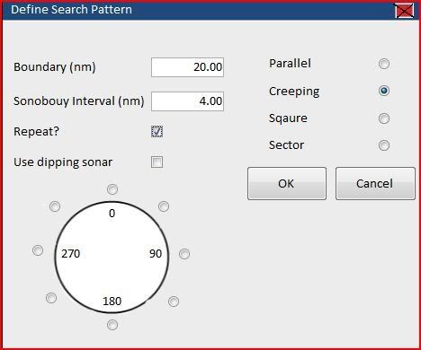

Ok I have now added what I think would be a solution to aligning the search, this is basically a ring of radio buttons around a circular image that depict the general direction of the search pattern.
So for example the player wants to do a parallel search pattern in the direction of 270, the player would then click in the radio button next to 270 select the other partticulars including the radio button for parallel and then OK to begin the search.
The radio buttons around the circle will basically tell the AI want direction to plot in, but I personally think that insted of exactly 270 etc etc there should be a percentage of variation in the direction that the AI actually uses just so its different everytime, because real life is not always that exact.
Here are some examples of different layouts to this affect...
Posted Image
Posted Image
The second image is depicting the same window idea but with radio buttons for the ranges. However I personally believe it makes the box more cluttered than it should be. And should the user not be able to designate their own ranges and intervals?
